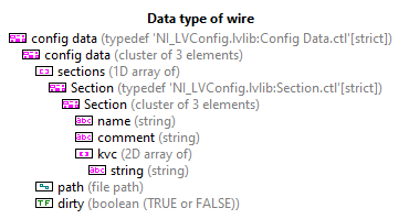

 Apparently it dequeues this cluster of path, boolean, and 1D array of clusters of strings and a 2D array of strings.

If the queue is invalid when it tries to dequeue, you'll get an error 1.  Since you are CLA, I am going to say you don't have a race condition where you are using the queue before it is created, but maybe some kind of unexpected error prevents the queue from being created in the first place?
