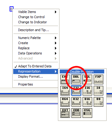

Can you post your code where you are setting the limits? It would be much easier to see. I am guess that you need to click on the control or constant and change it to a dubble format.
Tim
