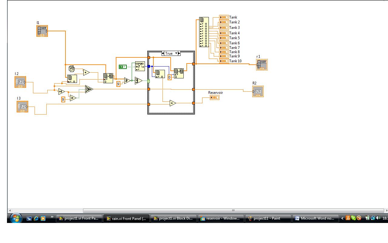

Im a student having trouble with a Municipal Water Managment System Project......Help please !!!
True is the same as you posted, i was just trying to get this working before i started adding to it....I'm using LabVIEW 9.0

No no Ray, i didn't for one minute mean there was a problem with your code 🙂 just me being a dumb ass, dam volume levels of tanks!! All works and my 'plan' was to use the code as a subVI but now it cycles through once then stays filling tank 10 !! aahhhhhhh this project is driving me mad !! I wanted to try and add the C&F tanks here and have the reservoir pumping back to the 10 houses but ggrrrrrrrr these things are easy to say, no idea how to start, this would be easier to build in real life !!

Message 25 of 77
(1,632 Views)
Two screen shots side by side there ^^^^^ 🙂

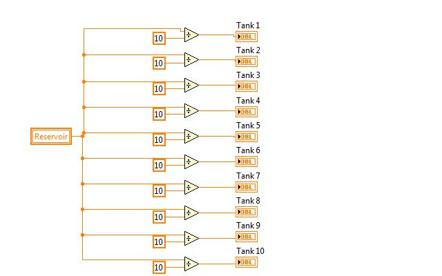

Using the reservoir as a lacal variable? Make any sense? Or will this just keep tracking levels and mean i cant set some sort of a trigger to pump from the reservoir when tanks get to like 20% full ?

You lost me with your last post..
Rule # 1   Never use Local Variables   😉
Dividing by 10 will give you the same amount in all 10 tanks.  So you could divide by 10 once and wire the result to all of the tanks.  I'm sure you don't want to do that.

Local variables bad then i take it 🙂
Ya, not sure what i done but when i tried using as a sub-vi it got messed up...
Your right about that last post, doesn't make sense...don't mind me....(grasping at straws here 🙂 )
