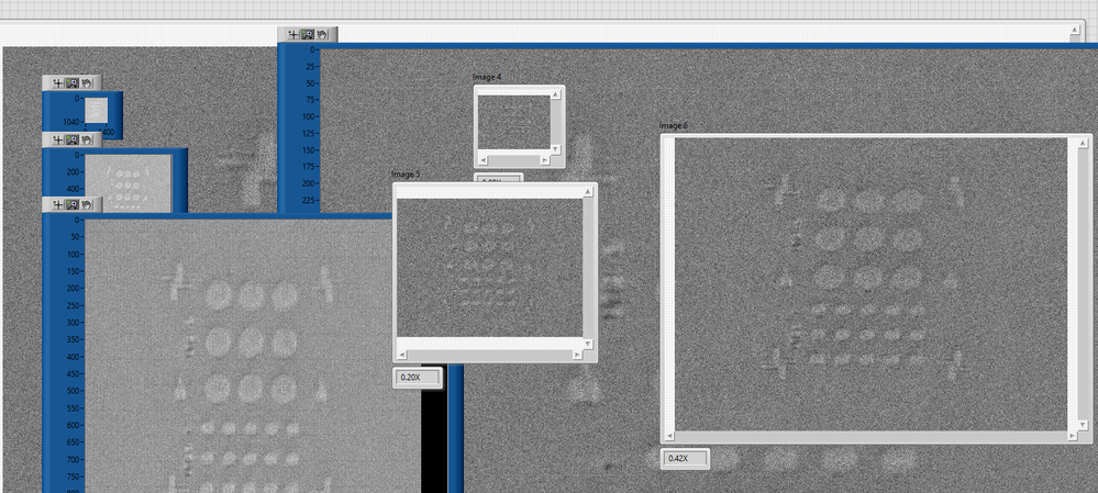

3. Downsampling for Display
Image Displays and Intensity Graphs apparently use different functions when determining the how to display data when the image is downsampled. I duplicated the image display and intensity graph a bunch of times and put them at different sizes. At different zoom factors, the Intensity Graph seems to get brighter, while the Image Display seems to stay the same. I wonder if the Intensity Graph picks the max pixel value in when downsampling while the image display takes the average.
Not sure if there's anything that can be done about this, other than knowing it's a thing and expecting it.
