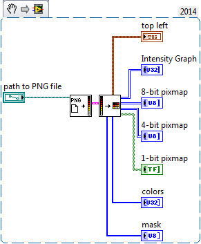

If this fails, add indicators to all the outputs of the unflatten VI to make sure you're getting the right array of data out. Make sure there is data in the arrays. As a PNG, you might be getting 24bit image data, not 8.
Cheers

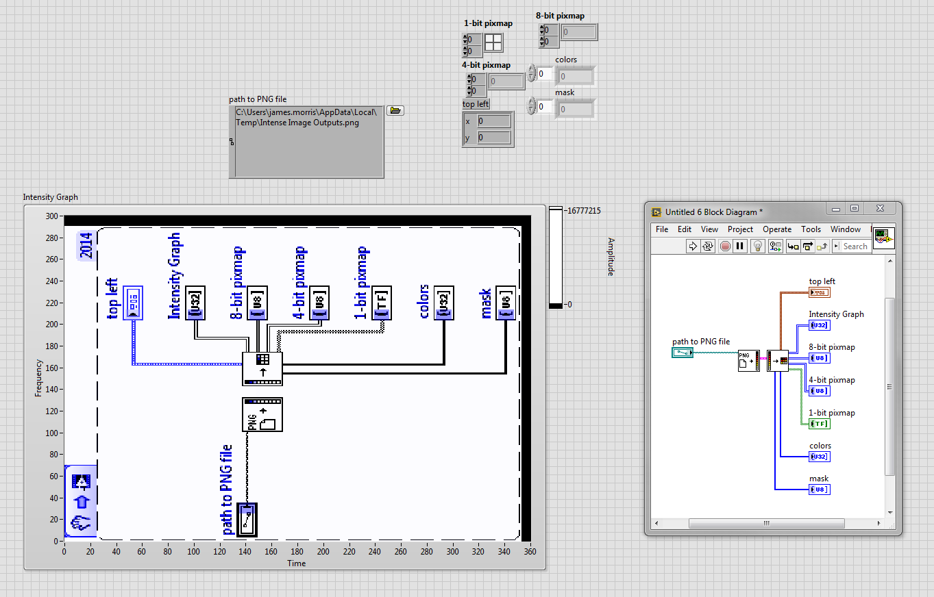

I made a self-referencing intensity graph of the snippet of the code:
Cheers
