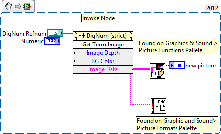

I kind of assumed you were using thisgraphics.png techinque from your original post Mark!

Dear James, Can I have your good VI? I don't know some functions. Is it a problem for you do send me the VI?

Hi Mark,
if you are using LV2012 or above, download the png and drag onto you block diagram to get the snippet!! (or find the items on the tools palette where I have told you each on is in the comments above each function) - it helps to learn where the bits came from!

James you are right. I have done it and it's ok. Sorry for my request! 😄
All the best! 😄
