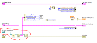

Here's the .sav file. I had to Zip the file in order for it to be successfully uploaded.
Here's a section of the code that pulls data from that file.

Ok it looks like you have everything you need to decode this file. I am not sure I understand what your problem is? What is your question?
If you look at the picture that you attached. In the binary file open you have a cluster attached tot he format at the top of the vi. This tells LabVIEW how to read this file. That is all you need to decode this file.
Right in the section that you circled in red.

Read the file in. Change the format and save it to the new format. Then when you open the file moving forward all you have to do is replace the binary format cluster. It is that easy.
