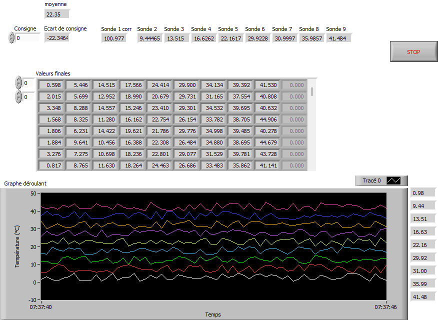

Bonjour,
Pour je ne sais quelle raison je n'arrive pas à ajouter des curseurs sur mon graphique déroulant.
Est-ce que quelqu'un sait comment résoudre cela?

Thanks for your answer!
I'll try to clarify a bit more what I'm trying to do with the code.
I'm trying to measure temeperatures using 9 sensors and save the datas.
I want to save different temperature levels graphically.
For example:
- Level 1, 70°C => user cursors to select data from 1 pm to 3 pm and write into an excel sheet
- Level 2, 100°C => user cursors to select data from 4 pm to 6 pm and write into an excel sheet
I'd also like to have a graph where I can see all te temperature from the star to the end of the "recording".
Do you think I could do this with a graph instead of a chart?
I hope this is clear, I can explain furthermore if needed!

Thanks!
The timer isn't ideal since I want to manually select the data and I want the amount of data to be flexible and not fixed.
Since I need to use cursors to select data as a "post-treatment" (after taking the measurements), what if I had a chart to show the temperatures in real-time, and another graph that runs when I stop the loop and where I can select the data?
This graph would use time and all the measurements as input.
Do you have any idea if this could be possible?

I tried to connect a graph to the array that stores all the data, but it doesn’t seem to work.
Ideally, I want a graph that displays all the measurements when I end the loop.
It works for the chart, but not for the graph.
I'd like to use the graph because I need cursors for the rest of my project.
Any ideas?

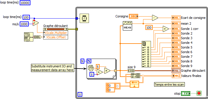

Sorry my bad,
Here is the code.

Hi Alex,
Why is the block diagram so large?
For me it works…
All I did (apart from code cleanup) is to right-click the graph and enable the "Transpose Array" option!
