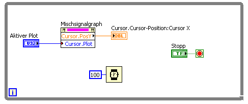

To get the y-values of the other Plots change the "Cursor" -> "Cursor.Plot" property and then read the Cursor.PosY value.
20077i3B2EA1D00B12E2A3
Greets CtheR

Ah ok.
You mixed up two different properties.
You've chosen "Mixed Signal Graph"->"property node"->"active plot"
but you have to use "Mixed Signal Graph"->"property node"->"cursor"->"cursor plot"
(Picture in my first post)
This will work.
Greets CtheR
