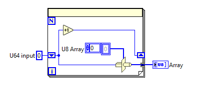

I am programming a unique identifier on some I2C Flash ROMs and increment the ID sequentially.  Kind of like a serial number. The iterations are pulled from the quantity I want to burn at the time. I want the byte order to be FIFO
The data portion of my I2C imports from an array once my address and memory location is inputted.   The I2C part is working great, I am just trying to get the auto-increment of my ID to work.

Okay, it looks like I got it now.  I forgot about the shift register function.  Thank you for the example, it kicked loose my creative block.

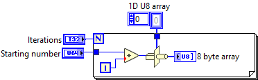

  • "Iterations" should be an I32 integer (blue)
  • Try to avoid overlapping wires. Hard to edit.
  • I assume you do your other things inside that loop, currently you only see the value from the last iteration because the loop spins so fast.
  • As has been mentioned, you can cast directly to a U8 array. No need for any pink.
  • Instead of the shift register, you could just add the value of the index terminal to the start value (after conversion/coercion to U64. N (and i) is I32, so you cannot add more than 2^31 anyway.)
Equivalent code would be:
Message 8 of 8
