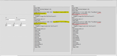

I have a script want to change the contents with front panel but after switching it turns to wrong form as the picture...

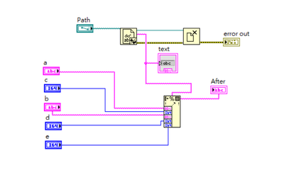

here is my front panel and program and hope someone can help my problem ….

Format into string uses %s, %f, %d, and there is none of those in the input string.
I don't see how your inputs result in that output.
If you post the VI we could actually try ourselves!
BTW. If you wire a path to Read Text From File, you don't need the close. It doesn't hurt though. See the help:
"The default is to close the file if it is referenced by a file path or selected from the file dialog box. If file is a refnum or if you wire refnum out to another function, LabVIEW assumes that the file is still in use until you close it. "

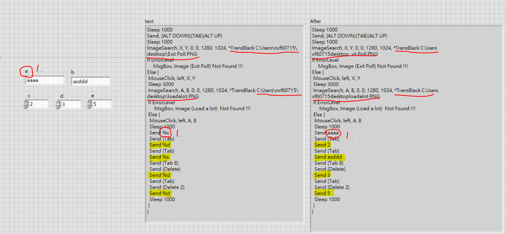

Format into string I using %s , %d in original text file so you can see output result changed below the After text like 1.Send %s --> Send aaaa
My question is from before changed the path in text like C:User\...  and "\" and some alphabet are gone …  I have no idea
I attached my VI at here

Ah, I was staring blinly at those red lines.
I assume a \ is used as an escape character by the Format Into String. A \n will become a line feed, a \s a space, etc. So the \ characters in the paths are replaced with bogus outputs.
Before using the format string input, you can try to replace each \ with a \\ (Search And Replace String) in that string. That will escape the \ character so the Format Into String outputs a \.
