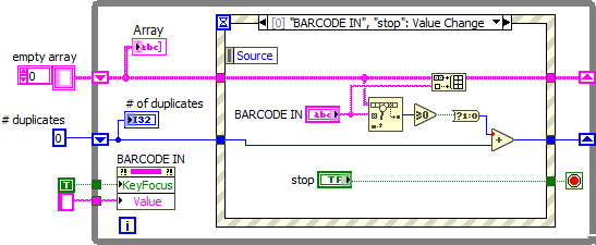

Here's one possibility to count the number of duplicates. No need to wait for a certain amount or pop dialogs. See if you understand it.
With code, often less is more.

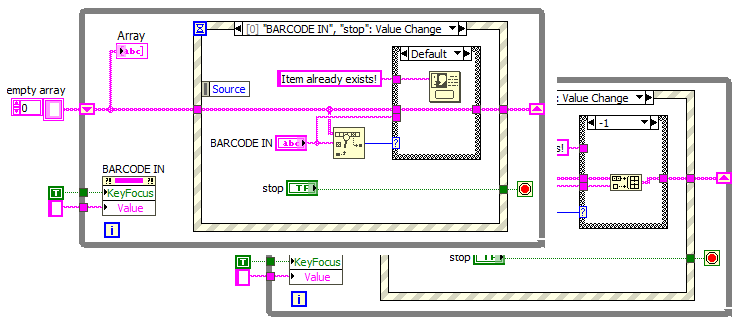

@aatm1412 wrote:
Yes, saving in a file is for record-keeping. I want the user to be notified if the string they've introduced has already been introduced before so I would like to tell if a string occurs more than once, but the program to continue.
So put the "built array" inside a case structure. If the item exists, notify the user and don't add it. If it does not exist, just add it.
