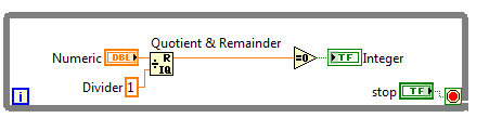

hi,
1. Divide your number by 1, use 'Quotient & Remainder' function.
2. If the remainder = 0 then LED is ON otherwise OFF.
Note: Change the data entry if you want it only for positive numbers
Amit

Of course all this only works well if the number is not derived from a calculation involving fractions. For example, the following will deny that 1 (e.g. 10x0.1) is an integer.
You need to be careful!
