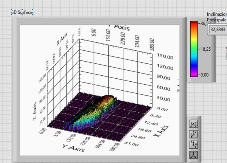

As you can see in the picture i have a cloud of point of my object. I have found the principal direction of the object thanks to the PCA. I would like to add this line in the graph but it's seem impossibile. I have the slope e and a point of the line.

Thanks for the answer.
Ok, this is the VI.
yes, it's only two parameters beacause i don't care for z data. i mean, i want to plot the line in plane XY. So this way a point and the slope should be enough.
The point is the mean X,Y,Z and the slope is the result of the PCA.
I would like to see that line in the same plot of the cloud of point.

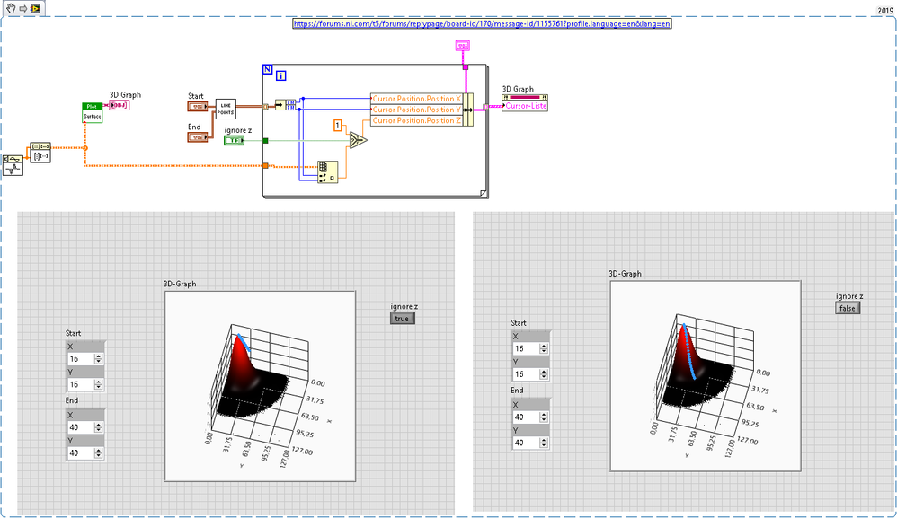

so, I created my own sample data for demonstration...
I don't think so
I'd say this mean will not be in the X,Y plane as Z is very likely to be unequal to 0
what about the line points which are inside your actual 3d point cloud?
