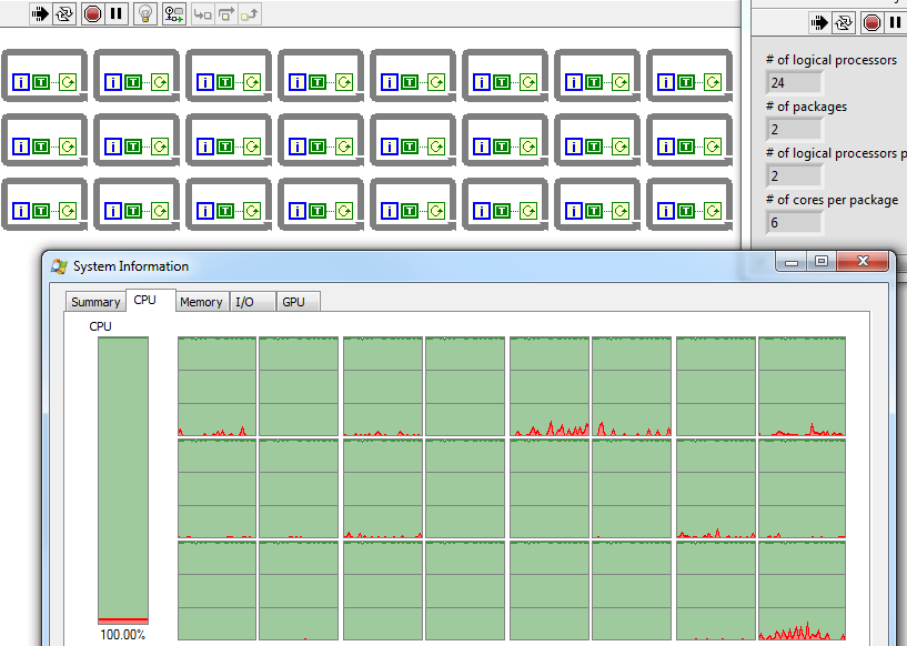

Do pretty simple test - put 8 while loops without any delays and see how many cores will be utlized. Then you should see something like that (in my case I have 2 CPUs each with 6 cores and hyperthreading is enabled - therefore 24 while-loops):
As you can see - overall 100% cpu load.
Andrey.

Thank you Andrey! It was a very easy check on the possibilities of my PC. All eight virtual cores are alive an running 🙂 OK, so I have to rethink the algorithm and its possibilities. (I was sure, it was suppose to use all possible cores. Obviously, it was not...)
