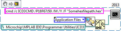

Example using the ICD3CMD.exe with system exec.vi call:
Simply call the ICD3CMD.exe with /? from cmd for full list of programing options.
edit: As for hardware you would need an ICD3 or PICkit3.
Thanks for the reply. I have ICD3. Do I need to set a path? What is the input to the path input?

I am using
C:\Program Files\Microchip\MPLAB IDE\Programmer Utilities\ICD3\ICD3CMD.exe / PIC16F684 /M/V/F "A.HEX"
Here A.HEX is my hex file. But it says illegal parser?
Kudos are always welcome if you got solution to some extent.

@Ranjeet_Singh wrote:
Do I need batch file?
Not necessary, but you could do it with a batch file aswell.
The path would be the folder where ICD3CMD.exe is located.
