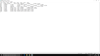

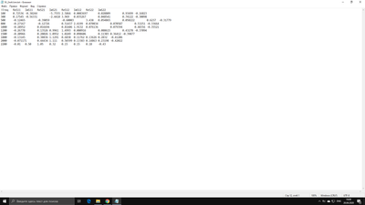

So that`s it. I need to do automatic interpolate between this two files and create new,as I`ve read eralier.
But I cant attach here TXT files to interpolate it :(. It looks like this. Maybe you know,that it is Touchstone file for different currents.
I can share TXT files in other source If it possible for you

Hi Yolo,
You can attach TXT files here in the forum. In case of trouble you can also ZIP all files into just one ZIP file!

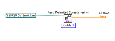

You also should simplify your block diagram:

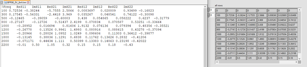

Is there any difference in LabView if i`ll just change expansion of this files?
I need to interpolate between two adjacent coloumns in final array which was created from this 2 files as it shown on block diagramm. So I think to use block 2D interpolate,but I laso have know ideas how to realize this in it,also because of wrong reading Interpolating block of data this files.

So,is it possible to do DBL paramater in reading block,without losing signs after delimetr point?

so what you have there is a tab separated text file.
Use the the appropriate read file utility to get a 2D array.
