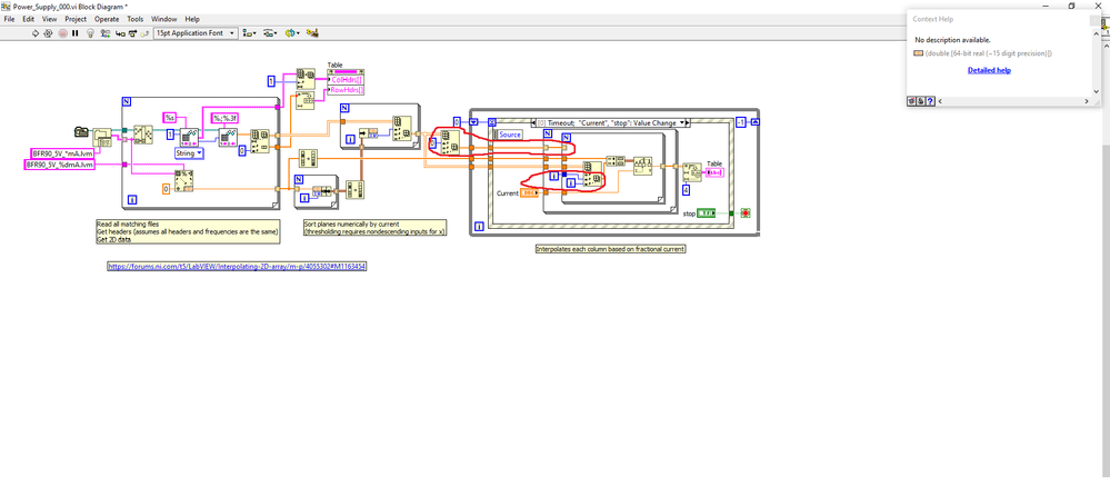

Thank you so much! You are really helped me. I`ve spent a lot of time to understand how it works and I finally about finishing my meditation. I just like to ask about this moment. What this signal do? As I understand it means a value of itteration based on number of elements in array,isn`t it? And how this value from each itteration goes to "Index array"? As i probably understand whole amount of iterrations its 8*9 (array size) = 72 and 72*5 (number of files). Could you explain me this moments, please?Power Supply.png

We have a 3D array and we need to get each possible column, then interpolate accordingly. I assume you inderstand the interpolation part.
It simplifies the code if we do "fake autoindexing" as shown, because the number of iterations in each dimension will be correct. Alternatively, you can get the array size, index out the size in the two needed dimension, and wire to the Ns of the FOR loops. Same difference, but more opportunities to make wiring mistakes. (There is no data overhead in my method, because the compiler knows what do do!)
