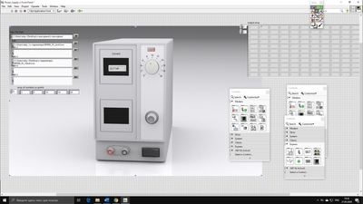

Now programm is done to interpolate between 5 files. I mean,how can I make it to interpolate for example only between 2 or 3 files without changing block structure or maybe when I`d like to interpolate more than 5 files. And for example if it will be files for 3,7,9 or 13 mA. How can I upgrade it to regulate this in real time without remaking structure of .VI file every time I start new experiment with different files and different number of it ?

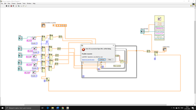

Thank you! You really helped me to find solution of this problem,but now I just have problem that after loop for loading files when I set on out of structure tunnel mod for "Last Value" in array goes just last array,when I change it to "Index",It doesn`t work.

Your code has no resemblance to any suggestions her and makes absolutely no sense. Why would you branch that 3D array 5x and autoindex on the same 3D array 5x in parallel just to build it into a 3D array with now 5 times too many redundant points, then trying to wire that to a function that expects a 1D array??? Your inner FOR loop just repeats the same calculation N times, but N is not even wired. Then you have a while loop that spins as fast as the computer allows, never producing any output until the loop is stopped, which happens immediately because your termination condition is "unusual". If you would delete the while loop and stop button, nothing would change! There are much better ways to parse a number out of a filename than using "search and replace pattern" twice in a row. Pure Rube Goldberg!
Programming is not about adding more and more random stuff until wires are no longer broken. At this point you are not ready to do any of this. Start with some basic introductory LabVIEW tutorials first!
