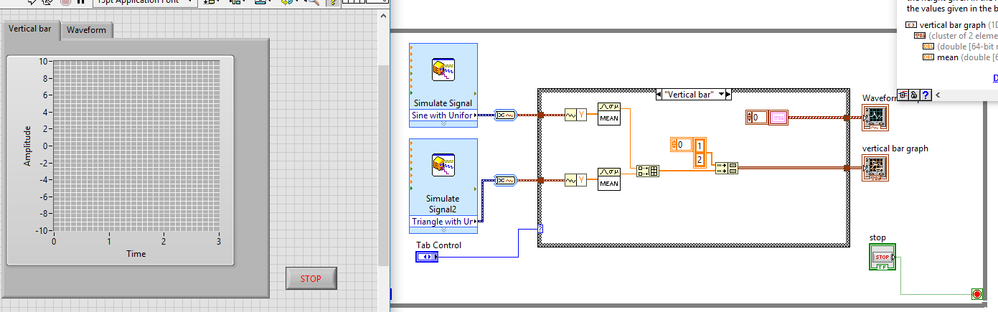

This sounds like a job for Tab Controls! Show/hide automatically and easy to work on just the active page.
Qestit Systems
Certified-LabVIEW-Developer
Message 15 of 19

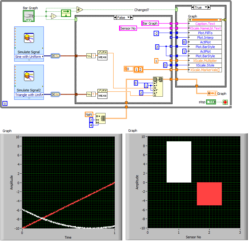

  • You only need to set the properties when the switch changes, not with every iteration of the loop. Property nodes are relatively expensive.
  • Since all your x-scales are spaced equally, all you need is a waveform graph. No need for xy graphs.
  • You can set dx with a property node.
Message 17 of 19
(1,727 Views)
Here's what I had in mind .... No XY graph needed.
(Note that you can make the bars have different colors if you do it right)
Message 18 of 19
(1,721 Views)
Thanks. I knew changing values of property nodes must consume some system sources. But I don't know how much. I totally agree that the property nodes needs to be reset only when the display mode is switched.
Message 19 of 19
