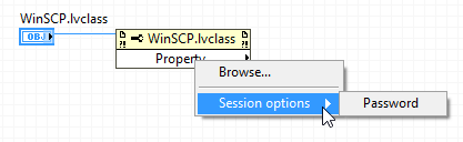

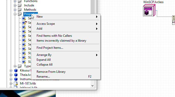

Should this still work?
I've just tried it in 2017 SP1, but it won't let me use colons in the property folder name.
E.g.
Group:Property
Foo:Bar
Message 7 of 8
(4,254 Views)

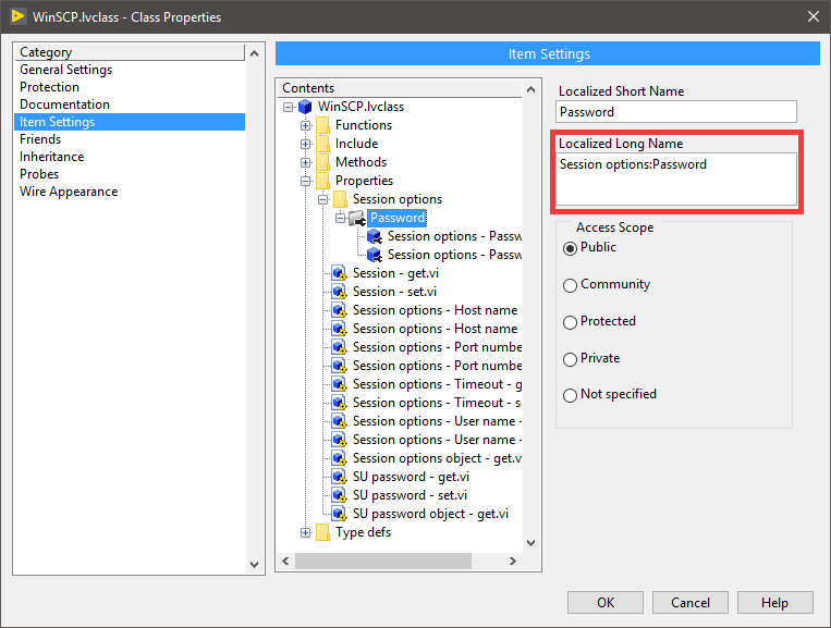

Aha, it's the Localized Long Name that needs to be modified, not the actual Property folder in the Project Folder:
ResultResult
