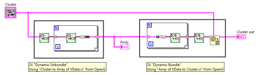

Is it possible to unbundle/bundle a cluster dynamically ?
I read some where its possible to unbundle/bundle a cluster using variant operations. I have tried the same and failed to do so. Can someone explain on this ? I have a cluster as attached below. I want to unbundle/bundle them dynamically(Inner cluster name might be different aswell).

I usually use the OpenG Toolkit functions to convert clusters to arrays of variant and vice-versa:
Also, if your cluster is more complex (with more levels), you may also use a recursive VI to bundle/unbundle an arbitrary number of cluster levels.
