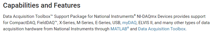

As ridiculous as it may seem (and certainly can be at points) calling it worse than malware is perhaps maybe just a tad bit whiny. The Matlab DAQmx support lists a mind boggling set of hardware:
This means you get all the automated tooling for local device detection, configuration, and firmware deployment, all the tooling for network device detection, firmware management, and software deployment, and all the myriad of additional support tooling and abstraction layers.
