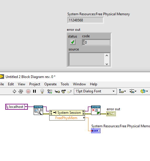

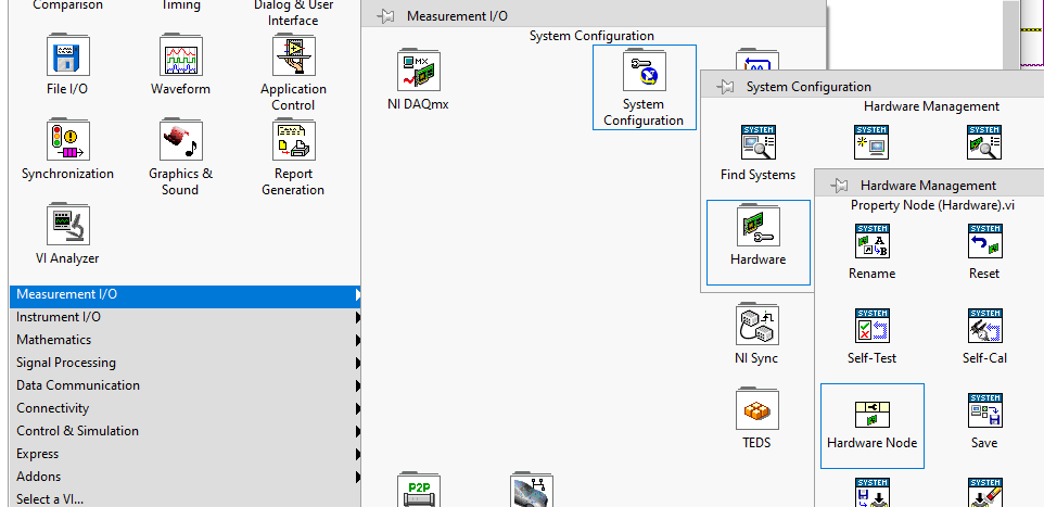

Accepted by Jim12345678
Here is the answer you are looking for, but probably not the answer you need.

This appears to work, but it brings the system to halt with every call.
