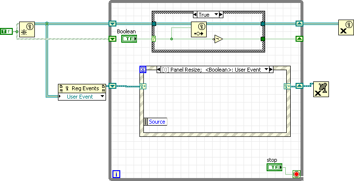

Here is one way to do it.  This vi creates a user event of boolean type (like condition) and registers that event for the event structure.  When boolean is true The top case causes User Event to occur and resets the boolean (shown this way for simplicity- but you would use a condition of your test to fire the event)
The event structure will execute the same code (here nothing) when either the boolean is set true OR the front panel is resized
Obviously you would want the structures in independant loops- I rushed and still got out posted twice!
