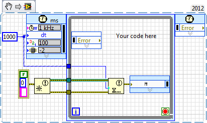

If the notifier gets a error notification it passes that error to the right side error node finishing the loop untimed.  Otherwise the notifier times out and passes on error to the node when you want to iterate

That'll work Jeff, thanks much.

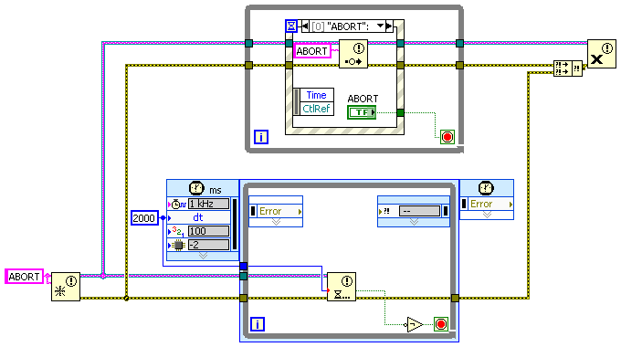

For a 1 minute rate you don't need a timed loop. Why not use the timeout of an event structure and also include a second event to stop the loop immediately by breaking the timeout?
(If you also want to handle other events while keeping the timeout interval constant, see my old example posted here. See also my comment to this forgotten idea)

If you want to use a timed loop, you can stop it at any time using the Stop Timed Structure tool. (even if the conditional terminal is hardwired to never stop!)
For example in the following code draft, pressing the stop button will stop and complete the timed loop immediately, no matter how long the interval is.
(Note: Configure the timed loop to get the current name, or set your own)
Message 7 of 13

I think altenbach's solution is the best one...you can configure the Timed Loop to execute at the rate you want, and you don't have to worry about when the "abort check" code runs in relation to where you are time-wise in the current iteration.
