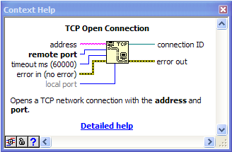

The TCP Open does have inputs for specifying both local and remote ports.
Message Edited by Dennis Knutson on 08-23-2007 09:52 AM

I am not sure the local port input really specifies the actual RJ-45 connector you want to use, but rather the "TCP" port, a number such a 3880, and the like.
If you do know that it does allow you to choose the RJ-45 connector, how do you map that u16 to the hardware you want to use?

Port means TCP port. If you want to use a specific nic, then that decision is up to the OS. If each is set for a different subnet, then the OS will choose the one based on the address you use with the TCP Open.
