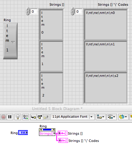

Ray,
Would something like this work? I typed a return after each character to create vertical text.  It would not be too difficult to create a formatting VI to take an array of strings and convert them to this format.
Lynn

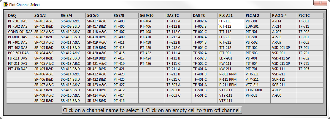

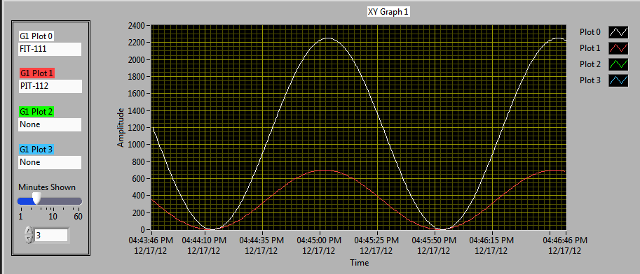

I have an application where the client (and end-user) wants to select among 64 channels that get displayed in 4 plots of a graph indicator
Maybe this will give you some ideas,
I had a similar requirement only there were 169 channels and 4 graphs with 4 plots each.
A text ring was too cumbersome. I tried using a table with drag and drop but didn't like the user experience at all.
I ended up using a table that pops up when the user clicks on one of 4 plot controls next to each graph.
The user selects a channel from the table and that name is displayed in the plot control.
The background color of the channels in the table correspond to the color of the graph label.(White in this case).
steve
Founding (and only) member of AUITA - the Anti UI Thread Association.
Message 9 of 14

The image is the actual size of the screen on the laptop.  I tried switching to 4 seperate graphs of the same size.  Client didn't like it because it was not the same code as the original software (lots & lots of constraints with this one).  Notice the channel names to the left of the plots?  Thats what the client would like to use to select the actual channels to be displayed but having something like a ring control or pull down menu to accomplish it.  I might get away with the right-click approach, but probably not on a multi-plot / single graph.  AARRRGGHH!!  I did make multi graph look identical to the one shown (I mean i-d-e-n-t-i-c-a-l), and it did not fly!
