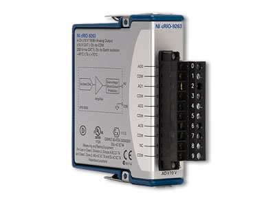

Is there is current limit on the NI USB module 9263 Analog Voltage Out (+/-10V)?
Is there is current limit on the NI USB module 9263 Analog Voltage Out (+/-10V)? I'm trying to run a current controlled servovalve, but cannot get the required current. The servovalved has a parallel internal resistance of 80 ohms, and requires 20 mA to function fully. Ohms law: (.02 A) * ((80*80)/(80+80) ohms = 4.5 V. Yet, at the required voltage, the servovalves don't move. Aside from hardware error (pursuing this by other means) what could be the issue?

Did you check the manual?
Page 12 says 1 mA.
For Servo valves, you really require some sort of amplifier.  See if the manufacturer provides any driver electronics for it.

Thank you for the reply.  On the German website allmost all of the technical specifications are given except the max. output current. For full specification you are redirceted to this site (see below). If the haeding is4-Channel, 100 kS/s, 16-Bit, ±10 V, Analog Output Module NI 9263, I would assume that the next sentences do refer to module not to the module familiy. And because  I found the missing bit of information within the next lines, there was no need to read further...
At the end, it was not a big deal, because the problem can be easily solved with a simple transistor circuit. However, it was just a bit  annoying, because the way the information is presented is misleading and that is the point I wanted to make...
