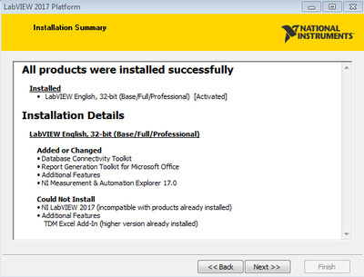

Thanks for the replies.
I removed all NI components. Then I installed only LV 2017 32-bit, here's the results:
The ONLY option selected was LV2017 32-bit. Everything else was marked as do not install.
Any other ideas? I'd really love to find out what it's "incompatible" with but I don't see any error logs anywhere that detail that. The logs only show that it installed and ended with error code 3010. This code seems to be "completed successfully" but requested reboot.

Is it actually installed? Do a reboot and see if you can run LabVIEW. It might have finished up OK but with a cryptic error message.
Message 5 of 11
(6,213 Views)
I did a reboot and could not find LV2017.

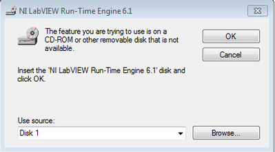

That worked to install LV, but then I started getting this message:
So I installed the rest of the suite, but I still get that message. According to online, 6.1 is incompatible with Win 7. However, it is still asking, and it asks every time I start the software.

Any reason why it would be looking for Run-Time engine 6.1?  Any unusual selection you made?
6.1 is positively ancient, dating back to around 2001, where LabVIEW 2017 is from , well, you guess it, 2017.
Message 8 of 11
(6,106 Views)
Not a single clue.
The two things I selected for install were:
  • LV 2017 32-bit
  • NI MAX (from the LV2017 32 bit installer embedded in the original installer)
Message 9 of 11
(6,104 Views)
