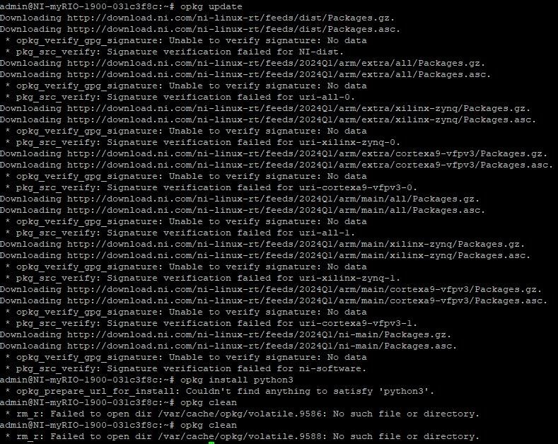

I tried what you mentioned, but I faced the following errors:
Message 8 of 10
(2,559 Views)
Your controller probably has no internet access. If you can enable Wifi on the myRIO, it would probably be easiest. Otherwise you have to temporarily bridge the myRIO USB virtual network adapter in your Windows system with the network card that is connected to internet.
Rolf Kalbermatter  My Blog

Dear Rolf,
I hope you are doing well,
Thanks for your response, The Device was connected through the WIFI, and I even checked using ping google.com.
Thanks for your time and support,
