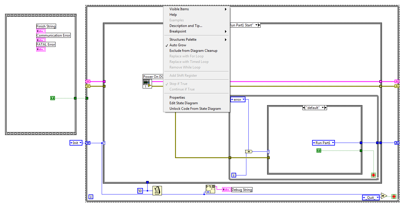

I am transitioning a substantial amount of code from Labview 8.2 to 2014, and I'm having an issue with state diagrams which were added using the State Diagram Toolkit V1.0.
The figure below shows the issue, Labview knows the for loop and associated components are associated with a state diagram, but the option to edit the diagram, "Edit State Diagram," is not available.  In Labview 8.2, which I am running on older machines, I would just select "Edit State Diagram" and another window with each state and arrows between the states pops up, allowing editing of the diagram.
I suspect I need to install the State Diagram Toolkit V1.0 software, but it is no longer availalbe on the NI website.  There is the new StateChart module which I've installed, but it is substantially different from the old toolkit and does not support it.  Any recommendations?

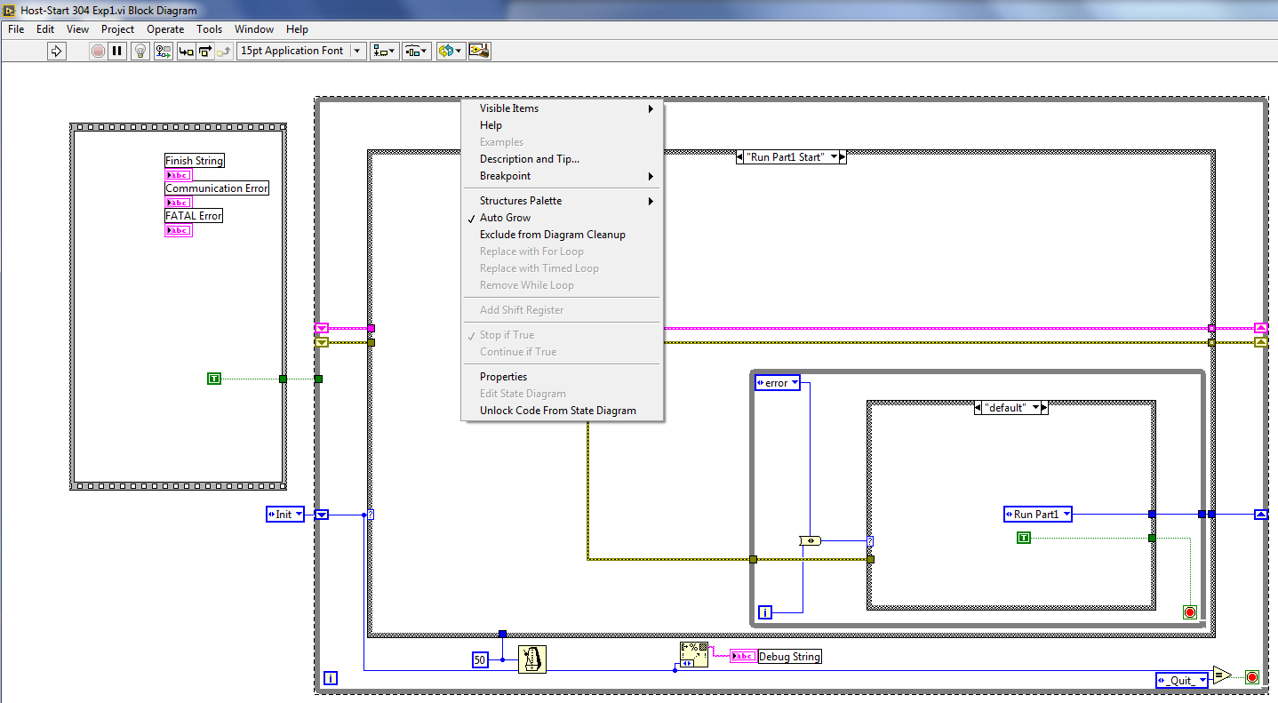

Thanks for the suggestions GerdW.
I should have explained in my original post that the "unlock the state diagram" command actually just gets rid of the state diagram aspect, and leaves the loop/case structure/enumerated value structure behind (see image below).
As to your recommendation, I'd love to update to the software to the new StateChart tool.  However the existing software and old toolkit is perfectly functional, and I have a very large amount of code for a sophisticated automated test system.  I think it'd take me 4-6 weeks to update all the test programs, which is way beyond the time alloted to my project.
So my question is still out there, is there a way to get a copy of State Diagram Toolkit 1.0, or some other solution so the "Edit the States" menu item will be accessible?
