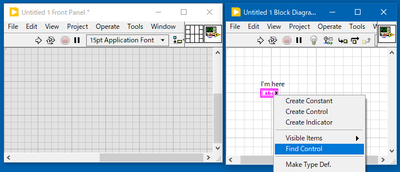

I think the controller is out of sight.
Look for it in Find Control.

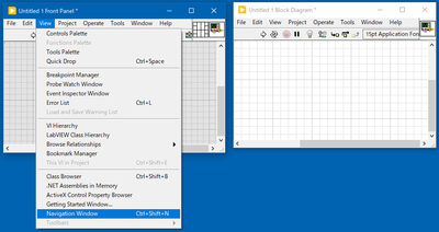

Display the navigation window and click on it.
