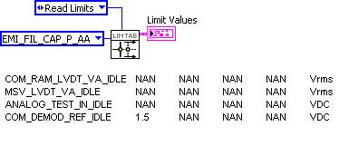

@Baji wrote:
Thanks for the reply. Do you have any Ideas or sugessions achieve the task. I attached the snapshot for better understanding of my requirements.
16979iE4DCDD5769843924
That looks like what I described!
The top enum selects the action and the left enum indexes the value.

This VI working fine for me,But if i do any change or Addition to the parameters in the file, i need go back and change the enum Parameters too. any ways to automate this??

If the enum that selects which set gets updated, and its type-def'd then all previous instances should be OK and where the new enum value is used, the same enum should get updated when the enum's type def gets updated.
