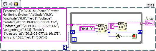

A very simple way:

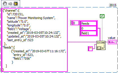

what about 'unflatten from JSON' in the String Function Palette??
Function>Programming>String>Flatten/Unflatten String>...

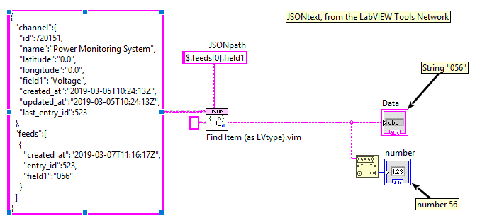

Try using JSONtext.
Message 5 of 8
(6,444 Views)
it worked ,
Thank You for suggesting the addon , its simple to build..
