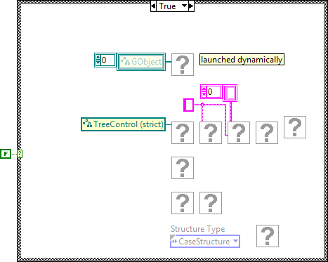

And a screenshot of "Data Readers and Writers__JKI_State_Machine_Helper.vi":
LabVIEW2019 - Bad VI - Data Readers and Writers__JKI_State_Machine_Helper.vi.png
The other VI "Tree__JKI_State_Machine_Helper.vi" looks like this:
So this doesn't seem to cause my problems...
