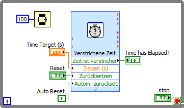

Hi Erwa,
a simple example to learn ElapsedTime usage:
