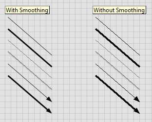

LV 2021 thick line decoration changed
The thick line changed in LabVIEW 2021.  More specifically, it looks like it is now anti-aliased with smooth edges.
While that is a nice feature, it breaks a bunch of my old UI things where I had expected the thick link to have no aliasing.
Ideally, this would be an optional property of the line decoration.
Thoughts?  This seems bad
See below:

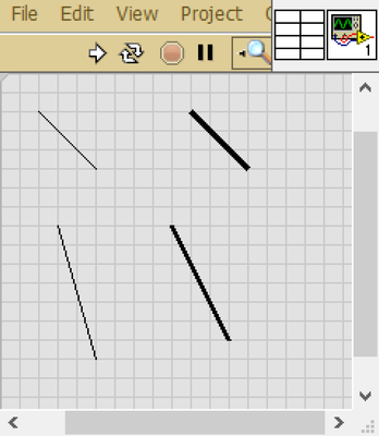

@dadreamer wrote:
Add this to your labview.ini and the good old sharp lines are back:
SmoothLineDrawing=False
I don't see any anti-aliasing, no matter what I set "SmoothLineDrawing" to.
Message 3 of 12
(2,161 Views)
It's for line decorations only (and the objects that include them). Other cosmetics seem to be unaffected.
Message 4 of 12
(2,145 Views)
I never get smoothing.  It always looks the same regardless of the state of SmoothLineDrawing.  It always looks like this:

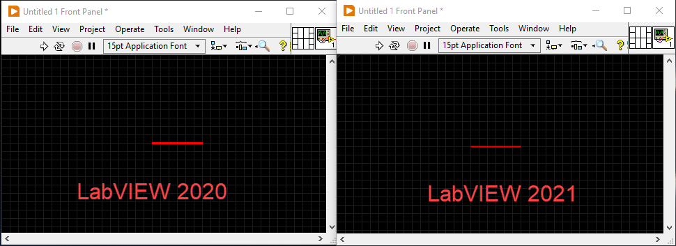

I just discovered this a few days ago:
The change seems to have happened between LV 2021 and LV2021 SP1.
What version are you using?

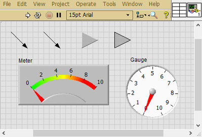

I'm right there with you Paul.  My first PC was a Mac 512K with TWO floppy drives!  The Lisa was way too expensive, but I hear it was quite a powerful machine in its time.  Just like us.  😎
BTW, I tried the SmoothLineDrawing=False trick and it didn't work for me either.  I have a basic HP i5 Win10 PC but it does have a GTX1050 GPU so I expected it to work.
EDIT: Just saw the post about it happening in LV2021.  I'm still on 2019.
