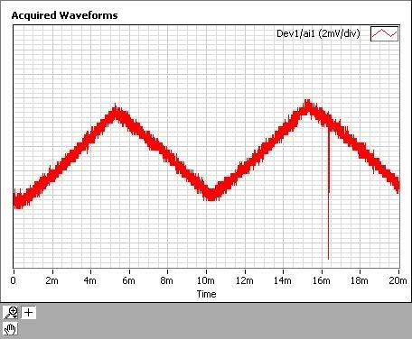

I have a similar problem with dual core Athlong 64 4200 machines on ASUS AV8 mainboards.  I have PCI-6251's to acquire data.  There is definitely a timing problem in DAQmx when used with fast dual core mahcines.  This is simply continuous simultaneous acquisition and generation on ao0 and ai0.
The 6251 is plugged into a CB-68 with nothing connected.  Normally I should just be picking up white noise and some coupling from the ao, but every so often I get those huge noise spikes.  They aren't there if I run the same code on a single core machine.  Also if I go in the BIOS and set the CPU speed to 1500MHz instead of 2100MHz the problem goes away.  The spikes are smaller if I connect the acquisition channel to a lower source impedance, but they are still there on the order of several millivolts even if I short the ai to ground.
