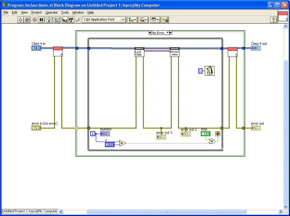

1) I saw it crash (confirmed)
2) I putan indicator on the iteration term and noticed it crashed after 650 times.
3) Put a or gate and stop loop if gtr than 650.
4) Code stopped with no error
5) Changed stop to 700
6) Now I get an error message having to do with your queues.
7) the VI (from vi.lib) named "Details Display Dialog.vi" show the erro but it has stopped as shown here.
Why is there a flat seq structure used in that code? (I should know better than to look at the code.
Ben
Message 7 of 38
(5,126 Views)
I changed your code as shown here and got no crash.
Are you sure your first version should have been wired like it was? It looks like you where shoving the wrong class back into the queue. LV can tolerate this right up until it is time to deallocate the buffer and then it can get confused.
Does that help you?
I'll ca ll this a bug for now since I saw that poor behaviour of the VIs in VI.lib.
Ben

Ben, thanks. I put the wrong object there on purpose. I was reworking some in my executionBase class and wanted to simplify it's lock/unlock methods.  Then I started notice these crashes.
I guess that's bad LV behaviour if the dev environment exits without any messages?
/Roger
/Roger
Yes sir!
I ran into a very similar crash myself but in that case I was playing games with type casting and screwed up.
You situation is very similar but there was what I will call "an implied type cast" when you wired the wrong type of class. Since yours is a typical type of mistake, this puts the ownership back on NI to protect labVIEW from LabVIEW.
Ben
