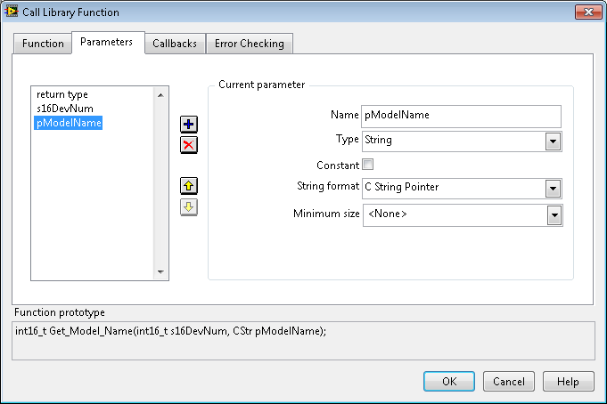

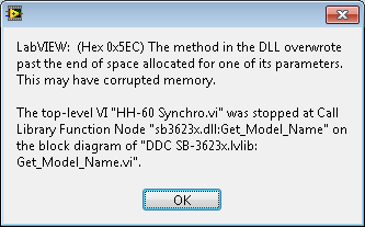

After going through more crash logs it seemed to indicate an error with the C DLL. I turned on Maximum error checking for all my Call Library Nodes. During execution LabVIEW stopped on one of the VIs and received a dialogue with the follow error. For the time being I have disabled the call to "Get_Model_Name". LabVIEW hasnt crashed since I have disabled the call.
Internal to the library I'm doing a strcpy which looks normal. So I beginng to believe the problem is with the configuration of the Call Library Node.

Well done: By setting the "Minimum size" to none you will have to pass a string to the DLL that must be long enough to take the string/answer of the function you are calling.  If you miss in doing so, the code is in trouble.

And how do you allocate the String that you pass to the second parameter? Just wiring an empty string constant to it? While in LabVIEW code you don't have to worry about allocating memory prior to calling some other VI, that is definitely not true when calling C functions. That function wants to write some information into that string and for that to work the caller (You on the LabVIEW diagram) has to allocate enough memory space for that.
You have to find out from the documentation of that API what the maximum buffer size is and allocate that much of string size. There are two ways to do that
1) Use an Intialize Array with an U8 as input type and the right amount for the buffer size and converte it with a Byte Array to String node.
2) Do you see the Minimum Size in the configuration dialog? Enter there the number of bytes the string needs to minimally have according to the documentation.
To answer the inevitable question right away. Yes it didn't crash in LabVIEW 2010 but did corrupt memory anyways somehow even there. Not every memory corruption immediately results in a crash. There are many possible outcomes from such corruptions and they can change depending on the computer you run your application, the amount of memory available, the moon phase and how your emotional state is at the moment (the last two aren't very serious but also not entirely unrtrue). The memory layout at the moment when running your function can very much influence what will happen from such corruptions. It can produce strange unexplainable results in your program when actual data values that are storing values in wires are overwritten, or your VIs can get corrupted and if you save them to disk afterwards get unreadable, or the computer produces an error dialog much later when you try to shutdown LabVIEW and your app, or there seemingly happens nothing (but the corruption still occures, it just didn't corrupt vital data in memory).
With the change to LabVIEW 2014 the memory layout changed somehow, maybe due to tighter optimizations in this new version and suddenly your DLL does overwrite memory that is very vital for the operation of your app in LabVIEW.

Thanks for the help and explainations everyone. In this case I know the maximum size of the string returned by the library function is 32. I will set the minimum size to 32.
