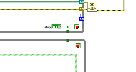

Sorry, I cannot really troubleshoot, because I don't have your hardware, but there are some glaring dataflow problems, for example the following is a typical beginner mistake:
The lower while loop cannot start until the upper while loop has completed, at which point the boolean is guaranteed to be true and the lower loop will stop after one iteration (the lower loop basically acts as a glorified sequence structure)
This also means that your queue will grow forever because nothing will ever get dequeued as long as the upper loop runs.

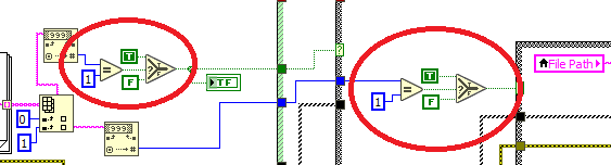

Then you have silly NOOPs such as the two circled fragments. If you would delete the select nodes, nothing would change! (that's just the tip of the iceberg). (See also)
