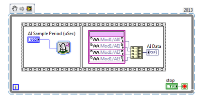

I am moderately experience in FPGA programming and got a new task of acquiring vibration data from a NI 9230 module and writing it to a file (DMA FIFO from target to host). When setting up the module in the project, Data Rate is defined by a drop down under the 9230 properties. If the Read I/O node is in a while-loop by itself, does the I/O node drive the loop rate? or do I still need to incorporate a Loop Timer as shown below? The examples for the 9203 show no Loop Timer present in the acquisition loop.
Historically, most of my efforts have been control based applications and using the NI 9205 to acquire PV sensor values. It always used the Loop Timer to drive acquisition rate in the While-loop. Communication between FPGA and RT was done via FPGA front panel controls/indicators and FPGA VI ref's on the RT.
I guess I'm looking for the nuts and bolts walk through on how the below loop operates with and without the Loop Timer.  When is the loop timer needed for controlling I/O Node Read/Writes? In the case of the 9230 having the data rate set in the properties of the project, if a Loop Timer is used that is slower than data rate set in the properties of the module, do you risk an overflow condition on some buffer that is internal to the 9230?

I believe the description of the "loop timer" function already answers the question to some extent: It states that the function will control the loop rate based on the value you specify unless other logic within the loop exceeds this timer value.
In your example, if the combined time of the 4 IO nodes (which is defined using the properties dialog) exceeds the loop timer value, then this will be the actual loop time.
It is also interesting to know what those IO nodes represent.
Each IO node element represents itself a VI which is hidden that provides a synchronized communication path to another hidden VI that handles the module communication (SPI).
Typically, these IO nodes will transfer information to this hidden vi on how to configure the general purpose IO expander which controls the signal mux and amplifier stages inside the module using SPI, and block execution until this hidden vi returns the value of the ADC.
(and some other magic for calibration)
The Minimum time between conversions influences to some extent how long the input signal is supplied to the input of the ADC after the mux and amplification, which results in a stable measurement within the specification of the ADC.
When in doubt, try to measure the loop rate using the "Tick Count" function
