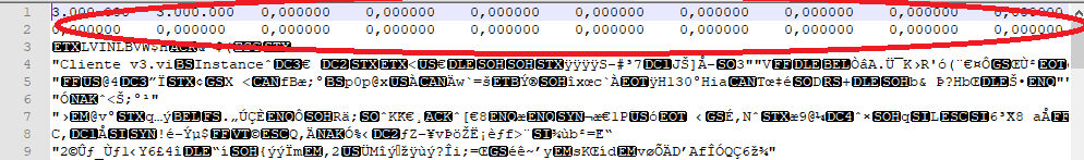

I ve the same problem, I am trying to open my vi file and appears:
"LabView: File is not a resource file.
The file 'cliente v3.vi' could not be loaded.
I opened it with UltraEdit but there is no any "RSRC<LF>" to be replaced by "RSRC<CR><LF>".
I dont know what can I do.
I have checked  \Documents\LabVIEW Data\LVAutoSave but I dont have any copy.
I have LabView 2013 and Windows10
I attach my file 'Cliente v3.vi'
Thanks for your help... I have the presentation tomorrow... and now I'm lost 😞
You overwrote the beginning of the file with formatted numeric data. the file is irreversibly lost.
Thank you for your answer.
Do you have idea how could it be? I have no idea how I have overwriten that or how I have corrupted the file.... It's for not doing any more
Thx
Maybe a path was incorrectly concatenated, like the path was relative to the VI and the name of the VI was supposed to be replaced with the name of the file to write.  But it wasn't, so the VI, itself, was overwritten.  😞
