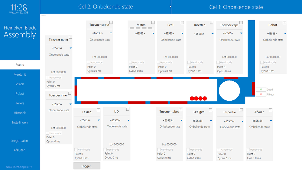

This is the front panel of my user interface VI (created in LV2015) :
What I am experiencing is this :
When the VI is running, the bottom part of the front panel is frozen. To make things clear, I've edited the upper screenshot with paint, and drawn a red horizontal line. See screenshot below. When the VI runs, nothing below this horizontal line is updated.

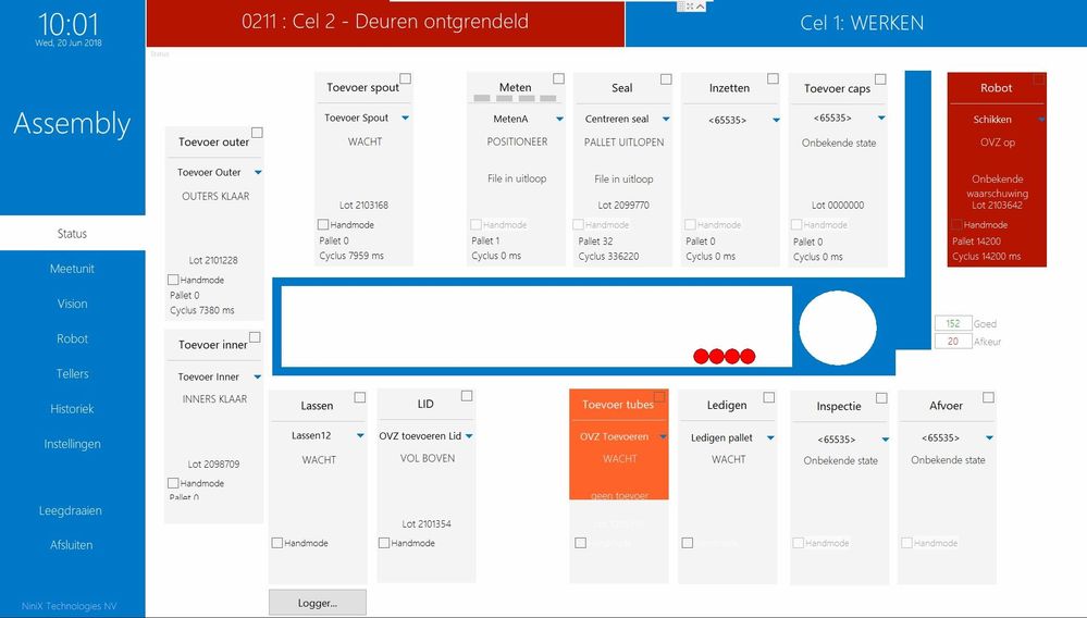

At the left of the screenshot, you see that we are using tab-buttons to select tab pages in the user interface.

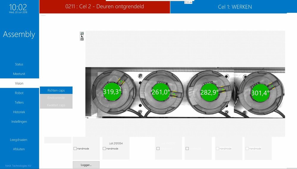

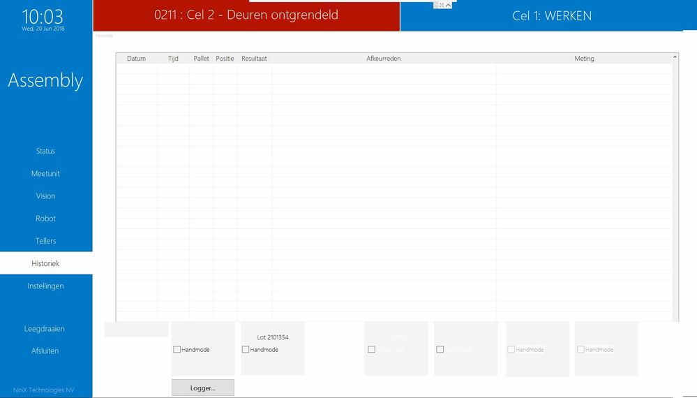

Below you see more screenshot when these other tab pages are selected. You see here clearly that the upper side of the VI is updated (selected tab is showing, but that the bottom part is 'dead'.)
When the VI is not running, the front panel is behaving fine. Then I can switch the tabs fine.
There is also no object of this dead size/position somewhere. Seems like an arbitrary dead zone.

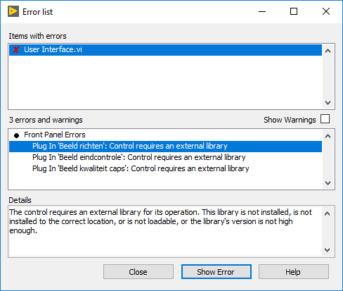

Can't run, some external libraries missing. What toolkits does it need?
