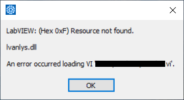

Did you find a solution for this issue? We are facing the same problem with a LabVIEW 2019 64-bit executable, which we provide to clients with an installer including the LabVIEW 2019 64-bit Runtime.
On most machines this works fine, but on some machines (maybe if LabVIEW was installed before?) users get the "Resource not found. lvanlys.dll" error:
Any idea?
