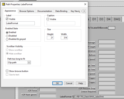

I can't attach the VI due to the proprietary information it has inside.
The attached image shows the difference between the two file path objects in the block editor. The blue arrow shows what exists throughout the project. The red arrow shows what it looks like when I create it. Right now, the two associated front panel indicators seem to have the same appearance and property settings. I've gone through several iterations of trying to add these. So I don't recall how I got them to that point. I'm sure it's a newbie issue (i.e. lack of understanding). Thanks!

Good grief! I thought it might be something that simple.

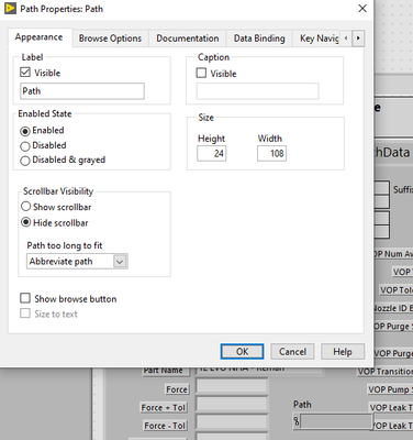

On another note, when I go to place a Classic File Path Indicator, the properties show the ability to change the scrollbar visibility. On an existing file path indicator, those options are disabled. Is there something that controls those settings that I'm not seeing?

I thought that might be the case also. I did try resizing the control but still had the options available. My concern was that I might be using a different control than what was originally used. That's probably not the case.

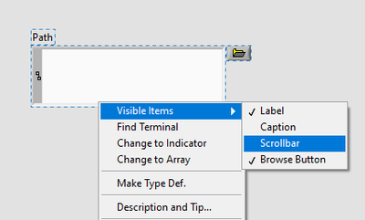

If you right click the path control, you can select the visibility of the scroll bar.
NOTE: the control (or indicator) must be large enough or the scroll bar is greyed out

If you drop down a new one, the box is normal one line size and the option is greyed out.
Stretch it to give it more height, and the option is available.
Shrink it back down in height, the option will be greyed out again.

I'm referring to the properties window. In a newly created file path indicator, the properties window allows the control of a scrollbar.
In an existing file path indicator, the properties are disabled.
It's not a huge issue. When I see that, I wonder if I have the same control/indicator. I can't find anywhere that is states what style it is.
