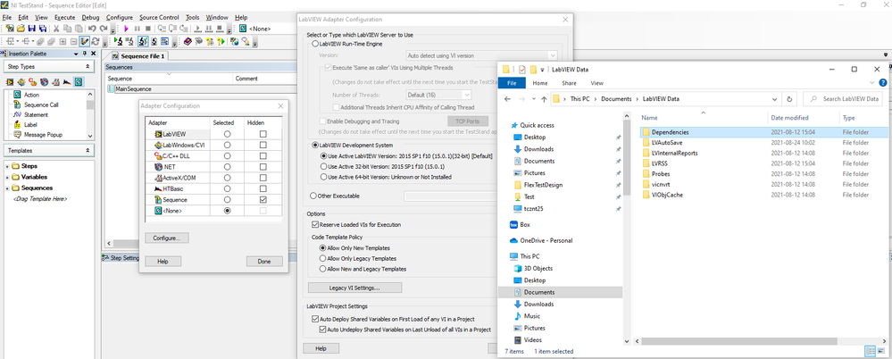

I am Using LabVIEW Modules in TestStand in Run Time Environment by compiling the Developed VI's, but every time when the New User is Logged in the same System again the Compilation of LabVIEW Modules is required.
Finally its Found that the information is stored in LabVIEW Data in Documents Folder.
So Every time the New user is logged in  the LabVIEW Data Folder needs to be replaced  in the respective user Documents.
Is there anyway i can bypass this process.

LabVIEW Modules  are my VI's and Its Stored in C Driver  and its called in TestStand  as a Modules, where my Module adapter is set to LaBVIEW RunTime Engine, so to make my LabVIEW Code to Work in RunTime i am doing a MassCompile of Developed VI's
When the New user is accessing the same machine again LabVIEW Module needs to be compiled.

When the New user is logged the VI's in the C driver remains as non Compiled Files, only when i replace the LabVIEW data (From the user where its being compiled earlier) Folder in Documents my VI's Work properly in Runtime Engine
which means the compiled info data is getting stored in LabVIEW Data under Documents.

I'm sorry for opening this old thread, but have you found any solution o this problem?
I have the same issue. System is running Teststand Base Deployment Engine / Labview Runtime licenses. It's not working once you create new Windows user because some compiled Labview files are stored in %user%\Documents\Labview Data folder. And this folder is created only when you run VIs for the first time in Development / Debug Deployment licenses.
Now for each new user I need to copy these folders or switch license, run once with full license and go back to runtime.
Can I point in Labview/Teststand to store these files in public documents or some other folder instead of %user%?

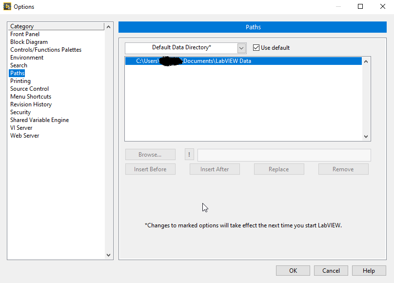

Have found something in LV options. Maybe this is the option to change. I'll reply once it's verified.
