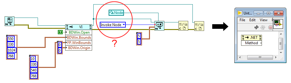

I followed NI's VI scripting tutorial, it's quite fun but it only covers very basic stuff and  there a few a aspects i don't fully understand. How are we supposed to find out which parameter to feed to  "new VI object " ?  here is a example, if I want to create a "invoke node(.NET)" (from  Connectivity/.NET palette), what am I supposed to choose for "VI object class" and "object style" ?
  Finding out "new VI object" parameterFinding out "new VI object" parameter
So far the closest thing to "invoke node (.NET)" I managed to create is  "Invoke node" from programming/application control palette.
help!

the create new object function returns a reference to the new invoke node. You can use this reference to edit the invoke node using property and invoke nodes. Note that you will find the properties for invoke nodes only after using "to more specific class" on your new reference.

Your invoke node is a new object. You are creating it by using the "create new object" VI (the first one after the red circle in your picture). This VI has an output "object refnum". Right now aou are only closing this refnum.
What i suggestes meant: wire this refnum to property nodes or invoke nodes to modify the new object (in your case also an "invoke node")

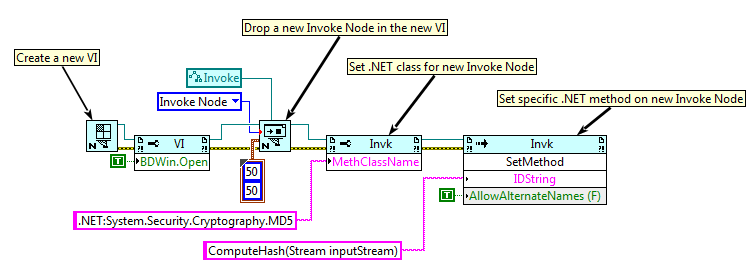

Here's a sample diagram that will create a new VI, drop an Invoke Node on its diagram, change its class, then change the method. I hope this points you in the right direction.
Message 9 of 18
(4,612 Views)
Wonderful! Thank you very much!
