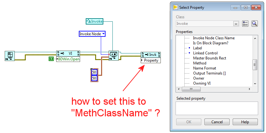

@Darren: I'm somewhat embarrassed Smiley Embarassed , I do understand what your VI example does, but I'm unable to reproduce it. I couldn't find a way to create that "MethClassName" property. I looked everywhere, aside from  a very short LabView help page , I couldn't find any direct reference to it, even Google seemed to be a bit lost here.
methclassname.pngSo I have two questions:
1- What is the LabVIEW UI path to set that MethClassName property ?
2- The class I'm invoking is in a C# .NET dll, how am I supposed to tell the invoke node what dll to use ?

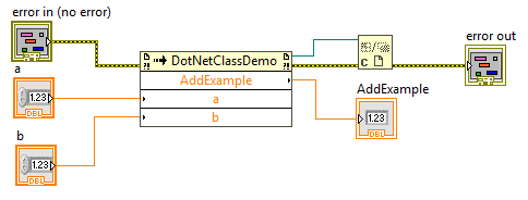

And here is the matching VI (also attached)
How would you create such a VI with VI scripting ?

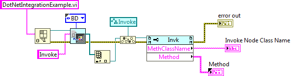

Once you've got that taken care of, the easiest way to figure out the right scripting parameters is to inspect a VI that is already created. For example, you can inspect your DotNetIntegrationExample.vi like this:
This code should give you the information you need to write the class name and method information when scripting a new VI as I showed in my previous reply.

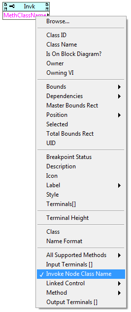

I double-checked in Base LabVIEW 2017, and the property is there:
If you don't see that item in the list, then something may be wrong with your LabVIEW installation. I can't think of any other reason why you wouldn't see it.

@Darren: Ha. I think I found the link I missed: I was looking for "MethClassName " property in Labview UI, but this is just a short name , the actual name is "Invoke Node Class Name" and the relation between theses two can be inferred from the help page for that property. Thank you for the clarifying screen shot.

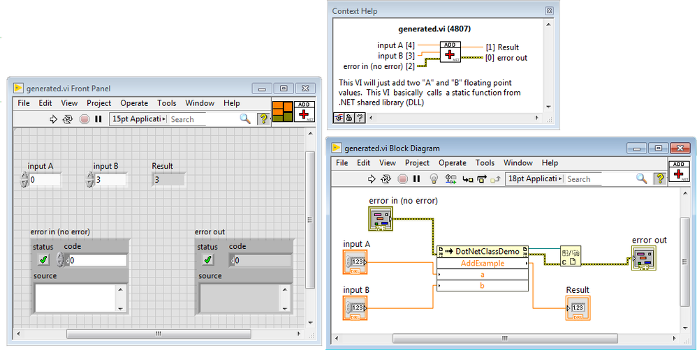

So.... I eventually managed to create what I wanted, i.e. creating a complete VI from scratch with Labview VI scripting. The generated VI just have to call a static function inside a .NET dll. For reference here is the .NET DLL source code:
namespace SimpleStaticClass
  public static class DotNetClassDemo
    public static double AddExample(double a, double b)
    { return a + b;
    public static string getActualDLLpath()
    { return System.Reflection.Assembly.GetExecutingAssembly().Location;
It looked like a simple enough proof of concept, but since I implemented  the whole nine yard (error in/out, closing reference, help, icon etc..)   I ended up with a monster. Yes, I know, I was supposed to create sub VIs but I wanted a panoramic view that I could use as a reference later on.
  And here  is the generated VI:
